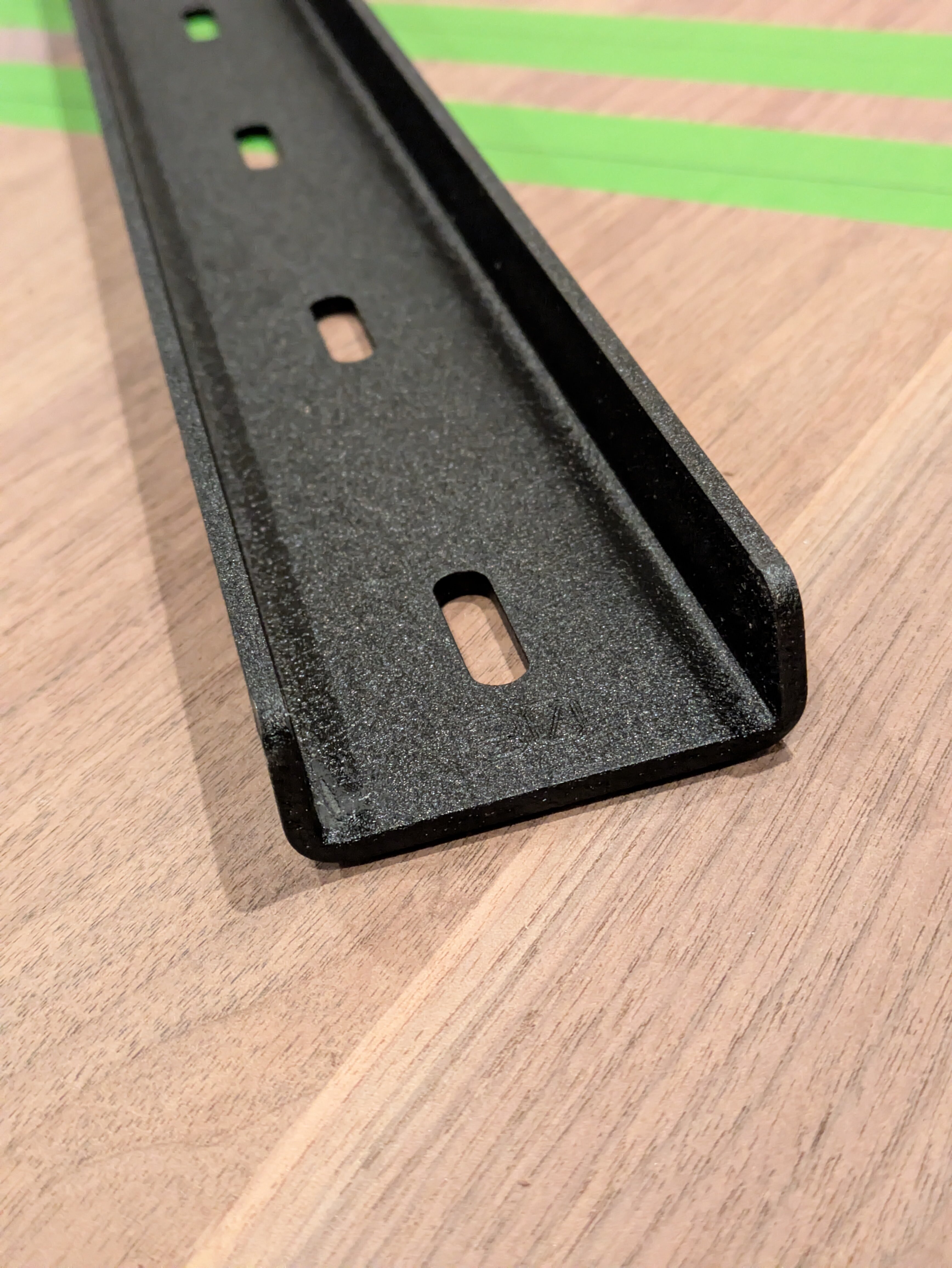

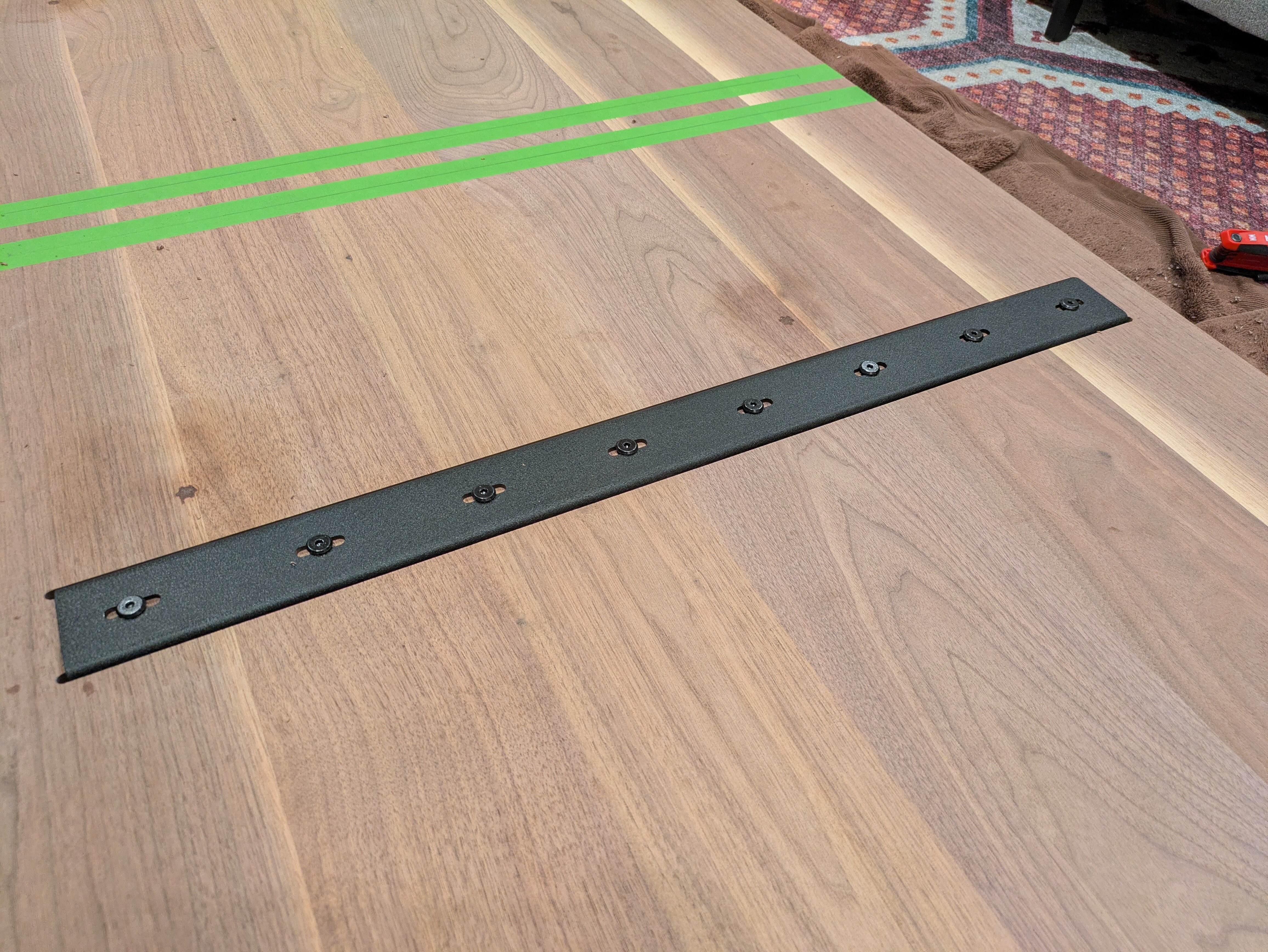

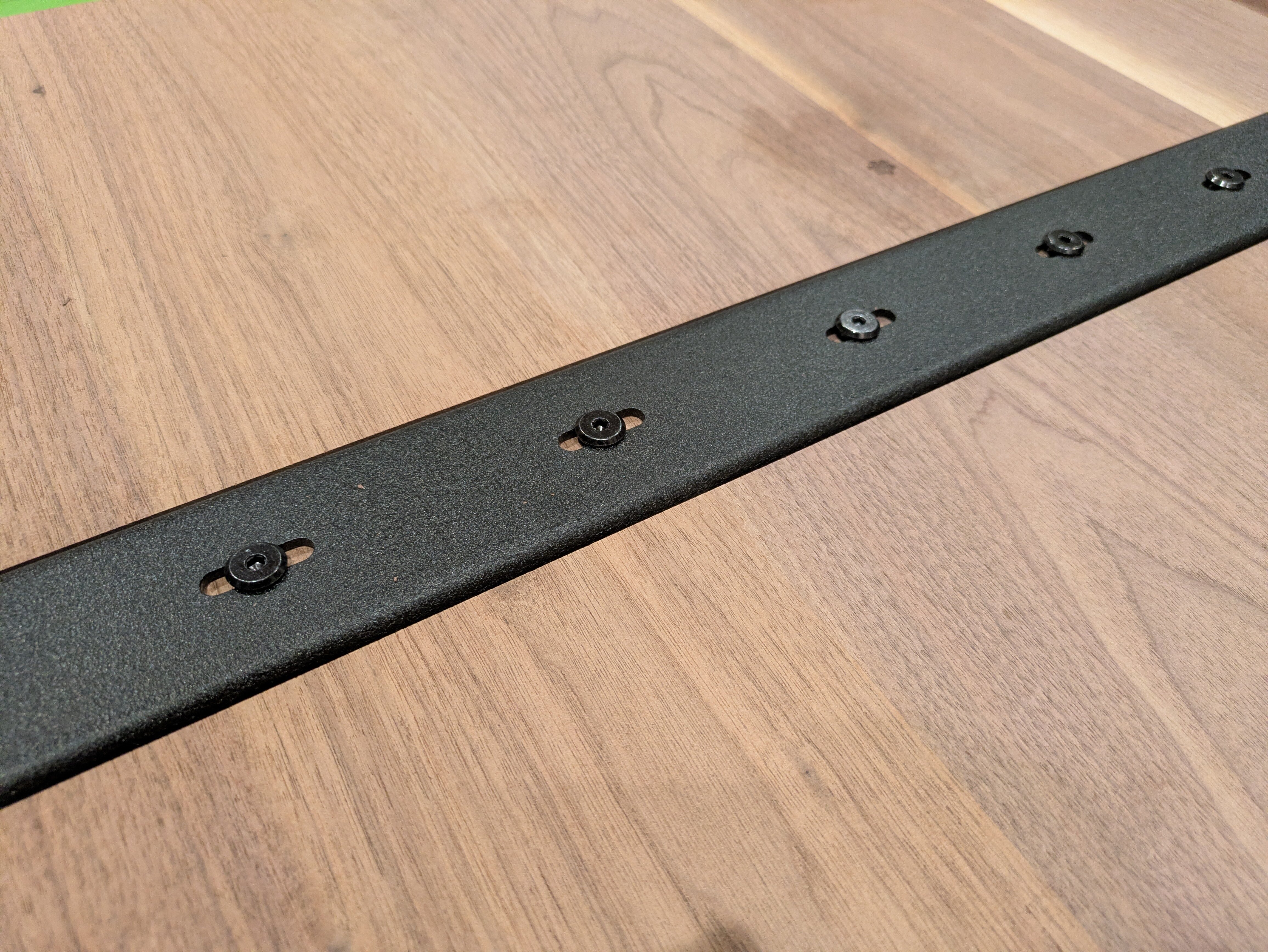

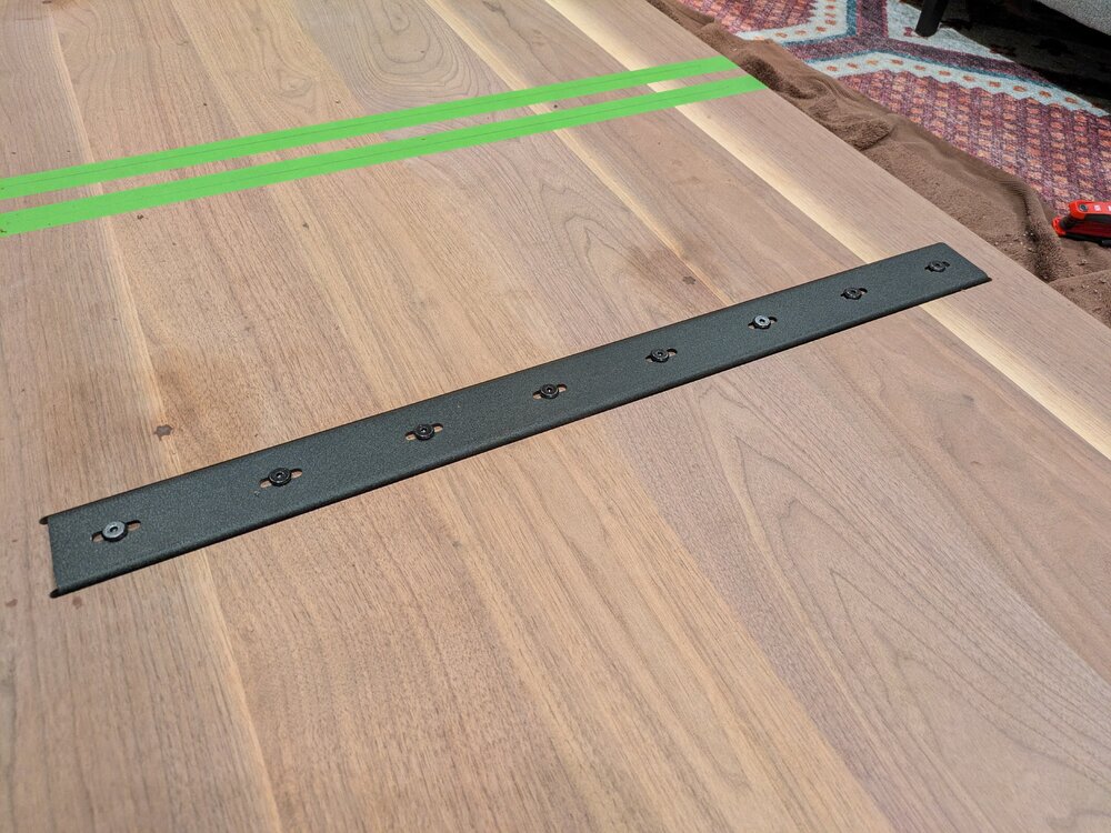

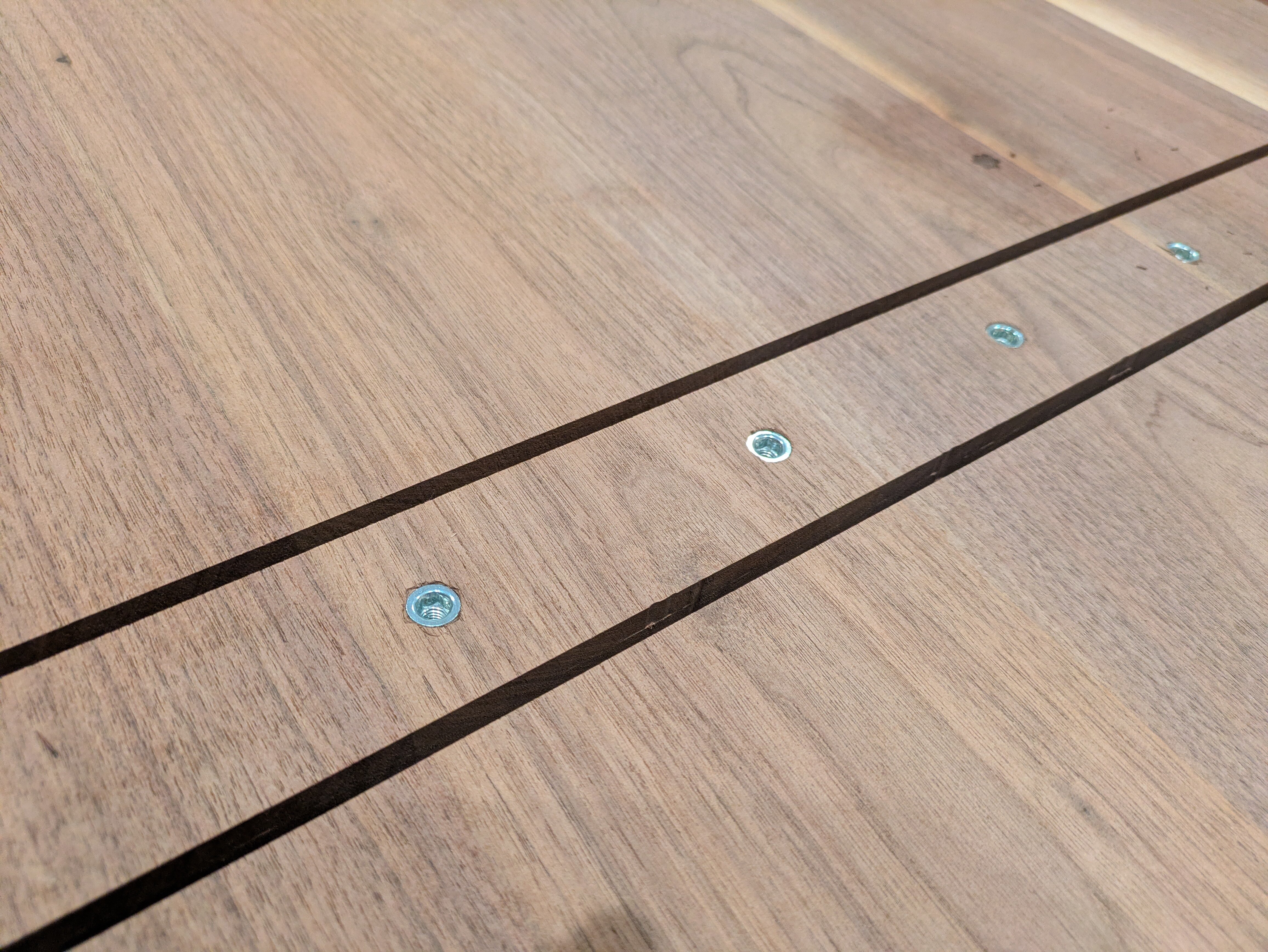

A little progress on this. Got the slab cut to size. C-channel braces arrived. I routed out two 1/4" slots and installed steel Rampa inserts with M6 bolts. I decided not to inset them flush because they'll never be seen. Will do the other this weekend and hopefully install the legs so it's ready for finish sanding and some Rubio.

Not visible and I'm doing something similar. I'm installing steel C-Channel. Routing out the slots and installing using flush threaded inserts. They won't necessarily pull a cupped slab flat, but supposedly help to keep it flat.
This is a 94x34x1.75 black walnut top I had ordered for our kitchen island a few years back when we had it renovated. We weren't quite ready for install when it arrived so, like an idiot, I left it in the box on the floor for about a week. Well of course it cupped about 1/4" on each side. I went ahead and finished and installed it, but It bothered me to the point that I ordered a replacement. I've had this one sitting on saw horses for two years with the idea that I would somehow fix it and turn it into a nice coffee table for our living room. Finally got around to stripping off the sealer I had applied and figured I'd try to reverse the warping before taking it somewhere to have it resurfaced. I dampened some towels, flipped it over with the convex side up, laid it directly on the towels, and ran a fan blowing over the top over night. 24 hours later and it's essentially completely flat. I have my doubts this is a permanent fix, but my hope is it stays flat for me to install some heavy duty c-channel braces that will stabilize it. We'll see. If that doesn't work I guess I'll find someone to plane it down, but I'll lose a decent amount of material so I'd prefer not to go that route.
