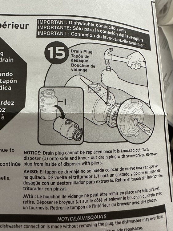

Clarkman? I believe there is a punch out on the disposer where the dishwasher connects. Did you remove it if it has one?
The was no punch out and the hole in the side if the disposal is apparently good to go.
there's always a punch out.
You've got it taken apart. Shine a flashlight in the dishwasher drain port, and look in the top of the disposer.  Do you see light?
This.  They have to be designed to be able to be used without a dishwasher.
