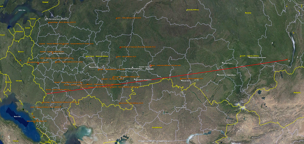

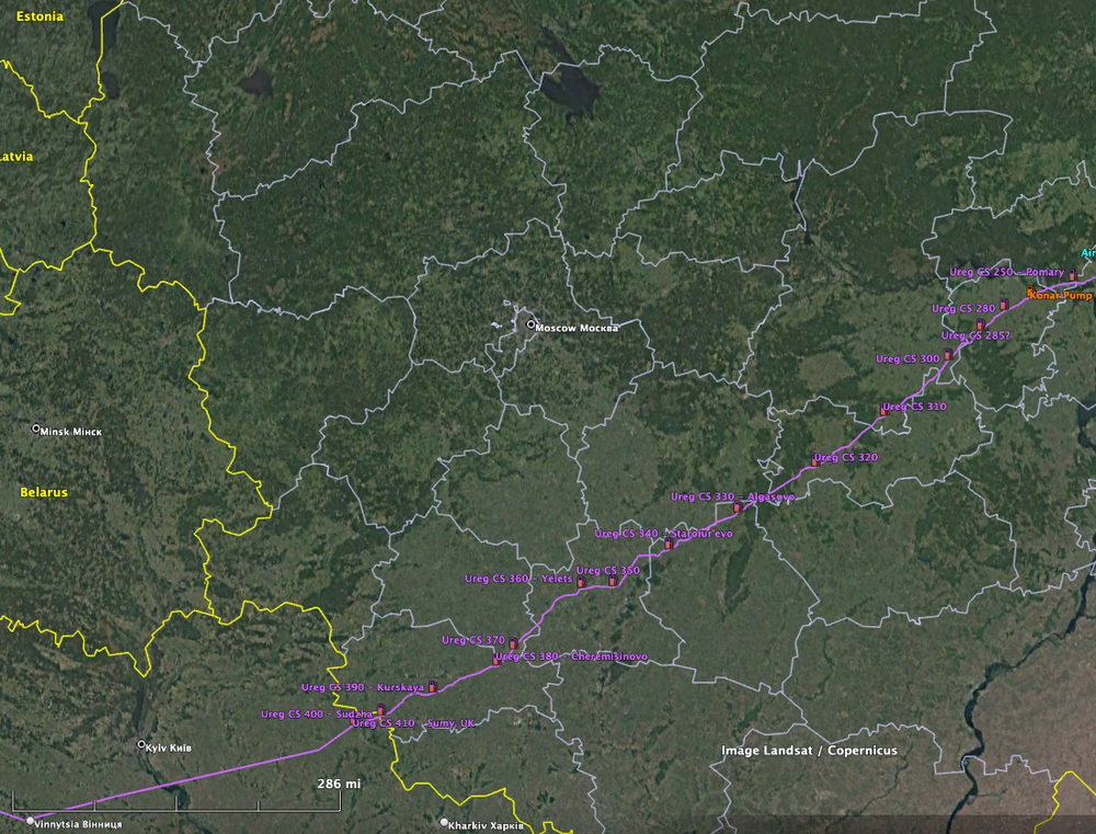

The Smolensk Nuclear Power Plant is the biggest power generating station in the north-western region of the united energy system of Russia. Smolensk NPP has an outer appearance similar to that of Chernobyl NPP units 3-4, as both are later generation RBMKs. (Hint: Smolensk does not have a Sarcophagus over one of the reactors.)
The three RBMK-1000 reactors of Smolensk NPP were commissioned in 1982-1990 (First Criticality for each unit Unit 1: September 10, 1982; Unit 2: April 9, 1985; Unit 3: December 29, 1989, with grid connection shortly thereafter).[4]
The reactors of Smolensk NPP are the improved versions of RBMK with a number of innovative safety systems
As you would expect, there is a very large substation near the plant, less than 1/2 mile from the reactor buildings, separated by a water canal.
Ukraine looks like they are dialed in to the point they can hit specific towers. But Ukraine needs to stay the fuck away from the nukes!!! I know I joked about "Aim small. miss small" and "This man can hit us any time he wants", but damn.

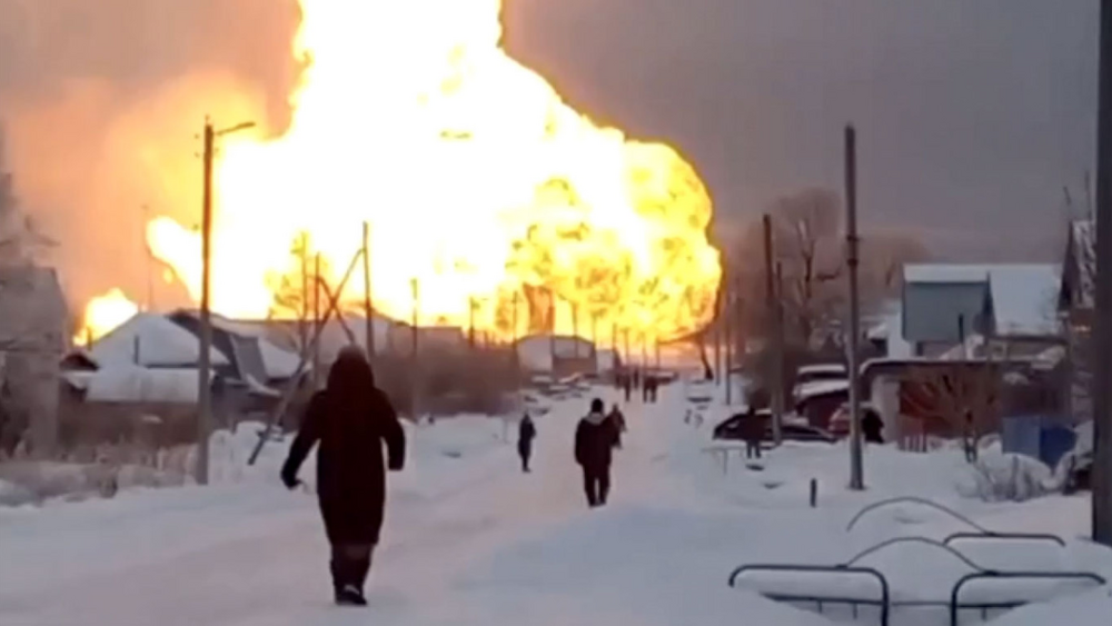

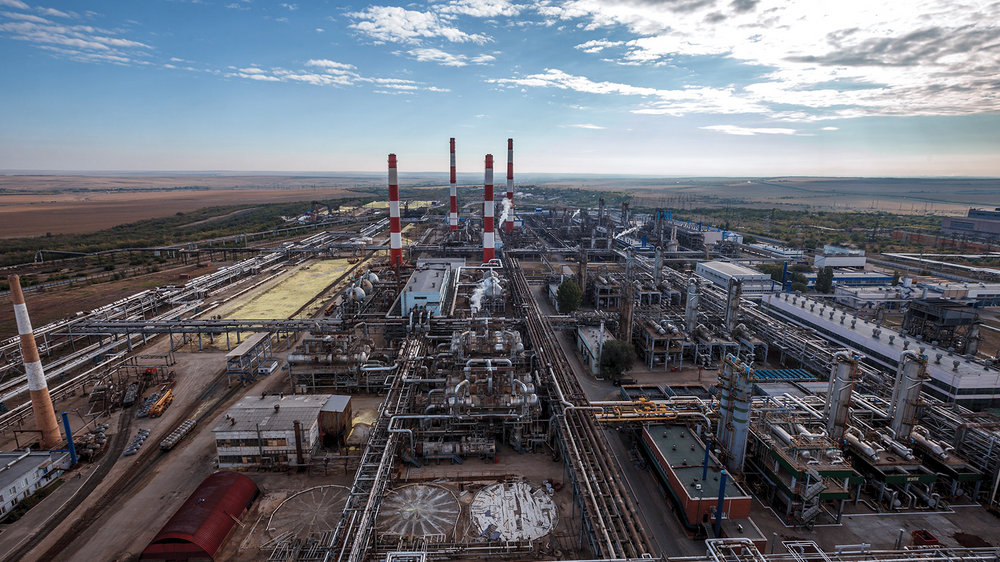

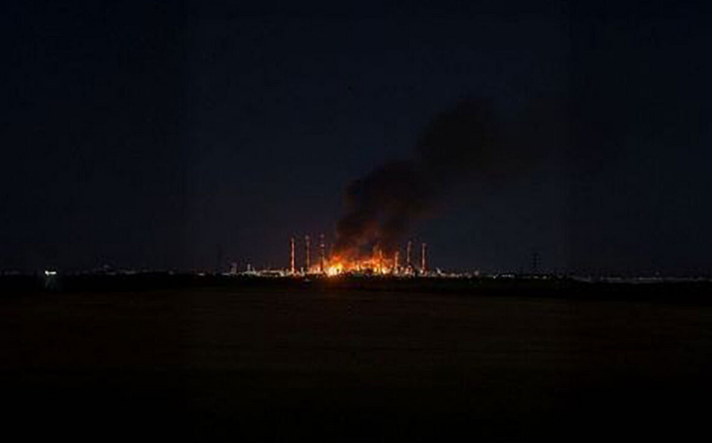

2 hours ago, Schulz2.0 said:Full disclosure, I love seeing Russian shit go boom in the night.
But, having spent my professional career working in and around gas processing plants, where the marvels of technology showcase the simplicity of Newtonian physics, where everything around you is a hazard and safety is preached every day, all day, until it becomes your way of life, it is with mixed emotions that I share my thoughts here. The people that work here don't carry guns, they carry pictures of their kids.
"Russia says overnight Ukrainian drone attack targets gas facility in Orenburg region Governor says fire broke out at a workshop of partially damaged facility, adds no casualties reported" - Burc Eruygur 19.10.2025
Nor was it a just a "workshop fire." I can't even write that without laughing out loud!!!
You all have been very patient with me as I drone on (you like that ?) about hitting specific targets rather than simply lobbing grenades over the fence. A gas plant has nothing but large pressure vessels full of high pressure natural gas and Natural Gas Liquids.And massive gas plants with a series of "trains" of multiple process vessels, heat exchangers, pumps and compressors, and separators and condensers, ...
My screenshot of the Orenberg Gas Plant.
I have highlighted in red the tall Red & White striped smokestacks you see in the photos and the video in the OP. The video is shot from the road to the south, ~ 3/4 mile from where the actual fire is. I have highlighted what I call "Process Towers" in yellow, which is where most of the intense fire is, between the smokestacks. It would appear that massive fireball envelopes most of the process towers.
The roar of the fire in the video is the expansion of high pressure gas at sonic velocity, depressuring rapidly from 1,000 PSI to atmospheric pressure, and to make it really exciting, igniting and burning. The heat from a truck fire will melt everything but the wheels and the drive shaft. This fire, with a constant fuel source, won't leave much of anything.
Just for fun, crank the sound on the video of the fire up to 10, 11 if you have it. This is from a cell phone 3/4's of a mile from the fire.
The Orenburg Gas Plant is one of the largest in the world, 2nd to the massive Empress Plant in Alberta, CA, (maybe something in Qatar?). This plant is 4 times larger than anything in the Lower 48 of the US, processing gas from the Orenburg region of Russia, as well as gas produced from the Karachaganak oil and gas fields in neighboring Kazakhstan.
The gas processed at the plant is the two extremes of natural gas; (i) Gas with any helium content is very valuable (used to be ~100x the price of natural gas) and usually becomes government property and has a processing plant built just to extract the helium, and (ii) the other side of the equation, gas with extremely high concentrations of hydrogen sulfide (H2S), mercaptan sulfur and carbon dioxide (CO2), "acid gases", which are lethal after 1 breath at these levels. The commercial spec on natural gas pipelines is 4 parts per million (ppm); some of this gas has 6.8 % H2S, 68,000 ppm.
This is a case where you isolate the fuel source, and let the fire burn itself out. Even then, the products of combustion include sulfuric acid and carbon acid, among other things. You always want to be upwind of these plants.

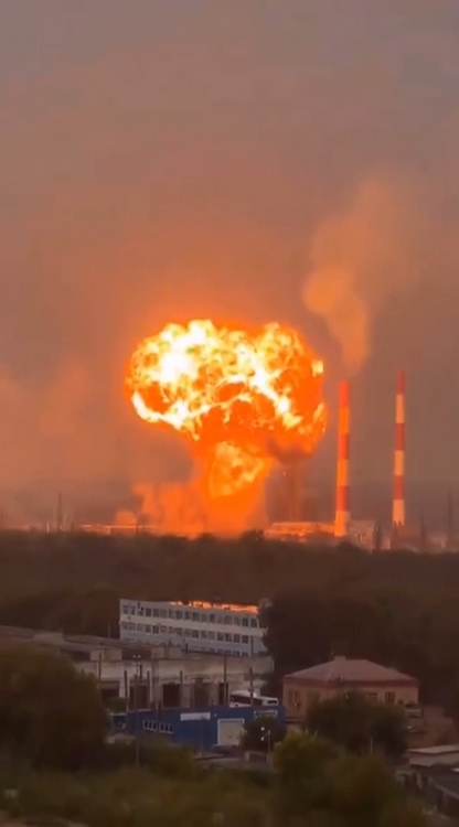

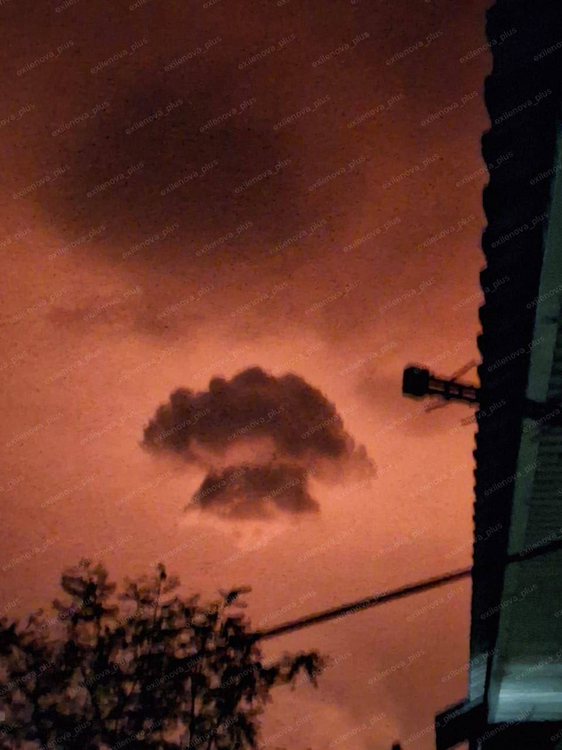

Nice shot of a mushroom cloud against the backdrop of a much larger fire, probably a smaller pressure vessel having a "BLEVE", a Boiling Liquid Expanding Vapor Explosion.
It occurs when a container holding a pressurized liquid, like propane or other industrial gases, is heated to a point where the internal pressure becomes too great for the vessel to withstand (the boiling liquid vaporizes at a higher rate than the capacity of the relief valve). This causes the container to rupture, and the liquid flashes into a large vapor cloud, resulting in a powerful explosion and, if the contents are flammable, a massive fireball.

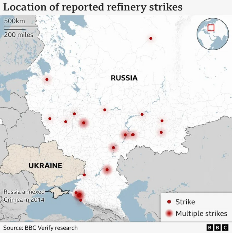

From Euromaidan Press - (me thinks Surly has a new subscriber)
Analysis of two months of deep strikes explains what Ukraine really targets at Russian oil refineries. The study reveals a deliberate focus on refinery processing units, whose loss cripples output far more than visible explosions do.
by Yuri Zoria, 15/10/2025 - 7 minute read (not a 30 minute Youtube video, ha ha!!!)
Ukraine’s two-month strike campaign against Russian oil infrastructure wasn’t random — it followed a deliberate pattern. In a detailed analysis for Mezha, Vadym Hlushko, founder of the OSINT group Cyberboroshno, reveals exactly what Ukrainian forces targeted inside Russia’s refineries — and why each strike mattered more than its explosion.
Amid the ongoing Russo-Ukrainian war, Russia is concentrating its strategic bombing campaign on Ukraine’s energy infrastructure, seeking to deprive civilians of power and heating ahead of winter. At the same time, Ukraine is in the third month of renewed long-range drone strikes against Russia’s fuel processing and transportation systems — including refineries and pipelines — aiming to disrupt military fuel logistics and reduce export revenues sustaining Moscow’s war effort.
Summer campaign marks sharp shift from earlier restraintFrom spring into early summer 2025, Ukrainian forces largely avoided striking Russia's energy sector. Between 20 March and 30 June, Cyberboroshno documented 19 confirmed hits on Russian defense plants and 5 on military sites, but none on energy targets. This restraint may have stemmed from diplomatic pressure or what was described as an “energy truce,” while the focus shifted to Russia's military-industrial facilities.
The effect of those earlier strikes on defense factories was limited. Ukraine’s long-range weapons achieved some success, but without a large supply of heavy warheads, they could not inflict decisive damage on Russia’s military industry.
That dynamic shifted when Russia renewed strikes on Ukraine’s energy grid this summer. In response, Ukrainian long-range drone units reactivated their own campaign against Russian energy infrastructure. President Volodymyr Zelenskyy stated at the time that Ukraine could now launch 100 to 150 drones into Russia daily. While that figure still trails Russia’s output, the effects are growing more visible.
BBC verify counts 21 russian oil refineries hit since — already 48% more than all 2024
A record 14 refineries were hit in Russia in August and another 8 in September, sparking fuel shortages in many Russian regions.
Map showing reported Ukrainian drone strikes on Russian oil refineries across the country, including multiple hits on major facilities.
Data confirms growing strike rate and clear targeting logic
Cyberboroshno analyzed only confirmed attacks — verified through satellite images or on-site videos — excluding unverified media reports. Between August and September 2025, 30 attacks on Russian energy infrastructure were confirmed. Of these, 23 were successful, 2 failed, and 5 had undetermined results.That translates into roughly three confirmed successful strikes per week. For comparison, from January to March 2025, there were 2.1 confirmed energy infrastructure hits weekly. Ukraine has not only maintained the strike pace but increased it compared to earlier phases.
The increased tempo reflects a more concentrated strategy. Instead of hitting warehouses or logistics centers, Ukraine focused its strikes specifically on energy infrastructure.

Cyberbotoshno notes that Ukraine’s campaign continues and conclusions remain premature.
In the first half of October, Ukraine has already hit more Russian fuel facilities.
* Ukraine struck more Russian oil refineries, including the facilities in Yaroslavl Oblast more than 700 km from Ukraine, Leningrad Oblast, facilities in Bashkortostan and Orenbug Oblast both 1,400 km away, and other processing plants.
* Several attacks targeted the Feodosiia maritime oil terminal in occupied Crimea, causing massive fires.
* Another target was a natural gas processing plant in Volgograd Oblast.In its October assessment, the International Energy Agency says Ukrainian drone strikes have cut Russia’s refining output by 500,000 barrels per day and will keep processing rates low until at least mid‑2026 — a forecast that does not include the impact of future strikes from Ukraine’s ongoing deep-strike campaign.
My comments:
IMO, I think the overall impact on Russian refining capacity is more than the 500,000 BPD going around. Just some of the photos of the burning towers indicate that the main process units were damaged/destroyed. Some of those process towers had individual capacities of ~ 100,000 BPD.
I just don't see that Russia has the skilled labor necessary to rebuild any of that any time soon. Anybody that wasn't working on a full time basis was probably conscripted and sent to Ukraine a long time ago. To rebuild refinery process units, there are probably 30-50 types of different craftsman required, each requiring unique skill sets that come from years of experience.
"If you don't have the time to do it right the first time, when will you have the time to come and fix it?"
I remember the days of 24-36 week delivery times on large equipment items (over a year on large gas turbines) that were critical path items on the project completion schedule, and the shenanigans of other companies trying to "buy" your stuff or jump ahead of what was already on the assembly line. (I myself did not participate in those shenanigans, I just used my insight and ingenuity to get what I was entitled to.) That was from normal supply and demand, not trying replace something intentionally damaged in a war zone.-

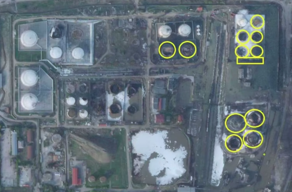

Updated photo of Feodosia Terminal, Crimea
Orange - Attacks prior to August 2025
Red - Attacks last week (early October)
Blue - Attacks this week
Satellite Photo
I think Ukraine is dragging their 'nads showing their capabilities of the systematic destruction of Russian infrastructure.
"Satellite images confirm 11 fuel tanks destroyed at Crimean oil terminal after Ukrainian strikes
A key fuel supply hub for Russian forces in Crimea has lost 11 storage tanks to Ukrainian strikes this month, with several more tanks unlikely to be restored to operation.by Maria Tril, 18/10/2025
Radio Liberty's Russian service has released satellite imagery documenting extensive damage to the oil depot in Feodosia, occupied Crimea, following Ukrainian strikes on the facility.Ukraine's drone strikes focus on Russian military airbases, manufacturing facilities, oil refineries, and energy infrastructure. According to military analysts, these operations aim to disrupt Russia's fuel supplies and inflict economic pressure. Attacks on oil refineries have hit approximately 38-40% of Russia's refining capacity, damaging production of gasoline, diesel, and aviation fuel, which has led to shortages and price increases within Russia.
The images show 11 fuel storage tanks completely destroyed as a result of Ukrainian attacks on the site, according to Radio Liberty. Several other damaged tanks are unlikely to be recoverable.
Ukrainian forces struck the Marine Oil Terminal facilities in Feodosia on 6 October. The General Staff of the Armed Forces of Ukraine described it as "a multifunctional technological complex for transshipment of oil and petroleum products from railway tank cars to sea vessels and back, as well as to road transport, which is involved in supplying the occupying army of the Russian Federation."
The massive fire that erupted following the Ukrainian strike could not be extinguished for more than two days, Radio Liberty reports.
On 13 October, Ukrainian military forces struck the Feodosia oil depot again.
The result of two Ukrainian strikes on 7 October and 13 – 11 completely destroyed fuel tanks, several damaged and unlikely to be recoverable, according to the reports.
The first Ukrainian strike on the oil terminal in October 2024 destroyed or fatally damaged 14 tanks at the hub that supplied fuel and lubricants to the Russian army in occupied Crimea. A Pantsir air defense system installed at the refinery in 2022 failed to prevent any of the three Ukrainian attacks."

3 hours ago, Parliament said:So what percent of Russia's refinery capacity is within Ukrainian range? How many drones and missiles would it take to visit ALL of those refinerles?
I'm glad I played Risk. Russia is fucking Huge?Screenshot of Russian refineries, 21 have been hit (orange) and 3 have not been hit (yellow), yet.
The red line is 2,700 miles, about the distance from Los Angeles to New York, or from Ukraine to the Rosneft Angarsk Refinery, north of central Mongolia. My guess is Ukraine smuggled troops and drones into eastern Russia and attacked from there, their "Doolittle '30 seconds over Tokyo' Raid."

MAKS 25 👀🇺🇦Join BlueskyThe open social network.🦅💥 Uralkhim Azot. A local resident claims to have seen 5 UAVs flying, 3 of which hit the factory, 1 was shot down, and another allegedly hit a house.
"Their are a number of potash mines in the area (general term for potassium compounds), used for fertilizers, many household products, fuels and explosives, including potassium nitrate. While modern explosives use other compounds, potassium nitrate is a key component in classic black powder, fireworks, and solid rocket propellants.
The Azot Branch of Uralchem is the only Russian producer of higher aliphatic amines, sodium nitrate, and crystalline sodium nitrite. The main products of Azot are ammonium nitrate, ammonia aqueous solution, ammonia water, urea, nitric acid, and nitrite/nitrate salts."
Ammonium nitrate was used in the Oklahoma City bombing.
Ukraine is targeting the refineries, pipelines, and related O&G facilities that generate revenue and fuel their economy, and cars and trucks.
The strike on the plant making electrical connectors and products and this strike on the Azot specialty chemical plant is pretty muy bueno.
Ukraine is not only blowing up the finished weapons, they are blowing up the primary components on the weapons.

The Urengoy Pipeline transports gas from Siberia to Ukraine to Slovakia, some 2800 miles, with 42 compressor stations along the way. They are spaced 60-80 miles apart, depending on the topography, among other things. Blowing up the pipeline is more damaging than blowing up a single booster station. When Ukraine "invaded" Russia earlier this year (last year?), they damaged a gas measurement facility on this pipeline, which caused a bigger accounting issue than an operational one.
The pipeline itself has a maximum operating pressure, and the higher the pressure, the higher the volumes moved (throughput). A single midpoint booster station (pumps or compressors) basically doubles the throughput of a pipeline, by increasing the pressure to offset the pressure drop.
With the multiple booster stations on a pipeline, you end up with a "saw tooth" pressure profile along the pipeline, with each station boosting the pressure to set point, (MAOP).
In the diagram below, with only Station "A" at the beginning of the pipeline, the volumes transported to the Terminal are "X". Adding a midpoint booster at Station "C" would increase the throughput to "2X". Adding Stations "B", "C" and "D" would would increase the throughput to "4X". Any capacity reduction at any one station could be minimized by changing the operating conditions at the stations before and after the affected station, with a minimal decrease in the throughput. Most of Russia's pipelines are operating at much lower volumes due to sanctions, so any longer term interruptions from any one station would be minimal.

Large diameter pipeline explosions make nice pictures. A huge fireball that goes full throttle until the pipeline fuel is consumed, with the dynamic effect similar to a large jet engine on afterburner, with a 50 mile long mile tank feeding it.

However, there is one major gas pipeline between the Bear and the Dragon, the Power of Siberia 1 Pipeline. This $55 Billion project, commissioned in 2021, included the 56" diameter, 1,860 mile pipeline from Kovykta Gas field in the Irkutsk Oblast (aren't you glad you played Risk?) to the China Border. I did check; there is a 9,500 ft mountain range they went around.
The Kovykta Gas Field is over 1,200 miles southeast of the Urengoy Gas Field in Siberia that
suppliesused to supply Eastern Europe, via a 2,800 mile pipeline.The good news is the natural gas produced here is the really good stuff, that contains helium and is rich in Natural Gas Liquids.
