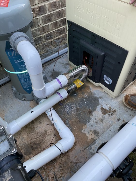

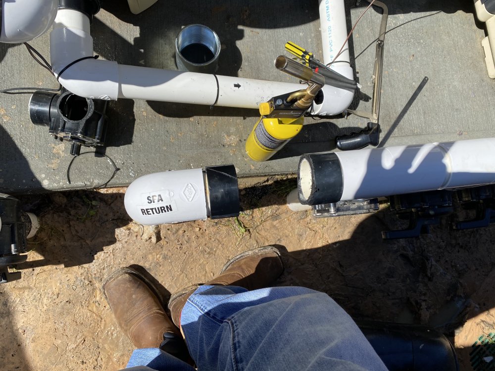

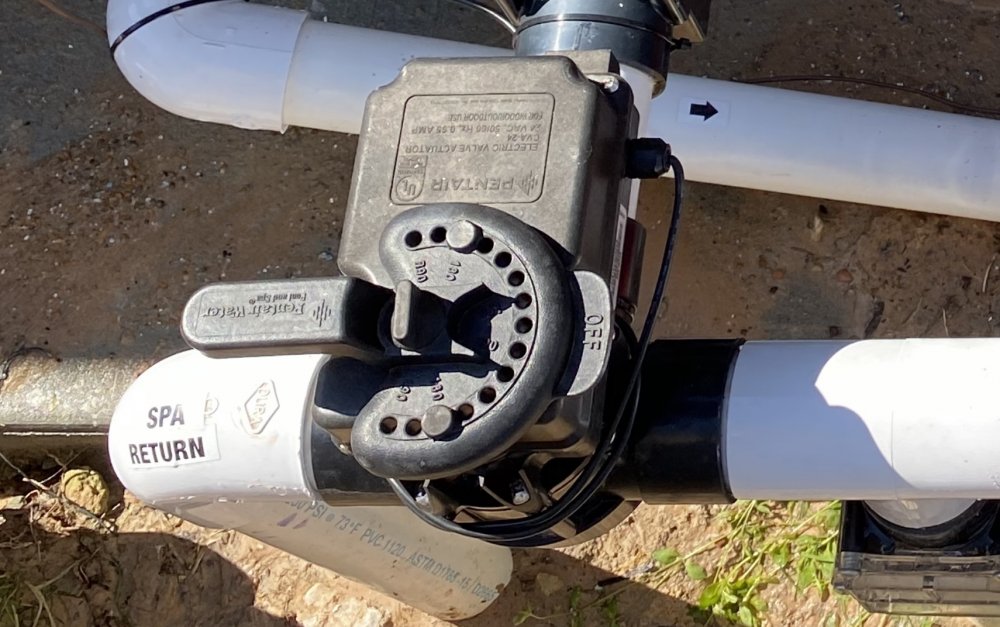

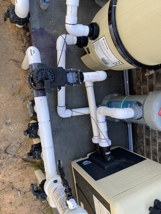

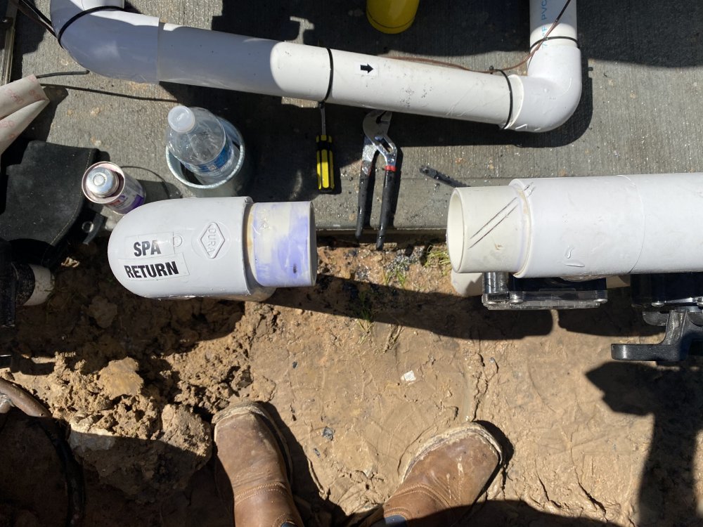

Was able to get my heater and actuator fixed. Replaced heater manifold, and pipe from heater return to a broken actuator that Tee’d to the pool and spa. Was worried about removing actuator, but it came off pretty easy. Sawed as close to it as I could, and cut the old pieces off, used a hot ass 3” rigid coupling, glue released. Got a little close on one side with the saw. But it didn’t go though. All in about $600.00
Was able to get heater bypassed til a new manifold comes in. Have a friend that owns a water well supply house. Got the hook up on some parts. Lot of stuff out of stock due to COVID and now the freeze, called companies all over the country looking for the manifold, all said, “you must be in Texas, good luck”...

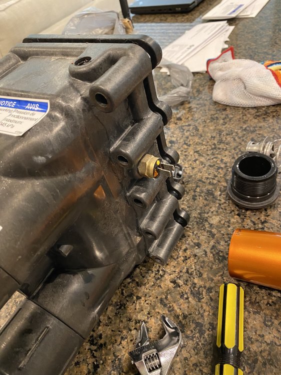

Tied going the JB weld route on my heater manifold.... didn’t work. Started splitting back open as soon as I started torquing the 10 bolts that holds it on. Going to bypass my heater so I can run the pump until I can locate another manifold. Kicking myself in the ass for forgetting to drain it, plug is sticking right out in the open.
Tomball here, pulled plugs on everything once we lost power, it was off for about 20hours, so just left it until today. New pool, and trying to do all that at 2:30 in the morning\freezing ass cold I forgot about the heater plug... busted manifold. Pentair Mastertemp 400. Seems they are no where to be found online... Will try and “temp fix” it or bypass the heater. Until I can locate one. Also have a cracked actuator tee. Fun times. Could have been worse. Good luck to everyone thawing out. IMG_1071.MOV
