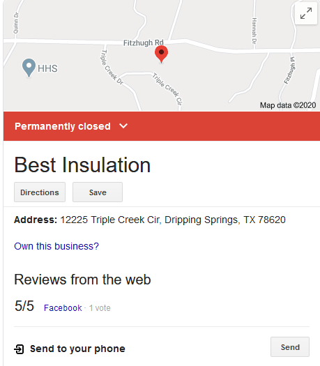

@deadshank , you saw that graphic?
Surly (the PC version, not TapaTalk) must now be allowing direct image posts vs. having to copy / pasta from another hosted source.  I did that as a screen grab via my notebook & posted here.
&... Apparently perm. closed operation.  Never heard of them out here.
I did.  The may have shut down  the DS location.  Have a call into the Houston sales rep.
Will report back with any breaking news.
The business is still open with multiple locations.
http://bestinsulationaustin.com/
The Drip address is where the money is sent and the books are kept.
Don't believe everything you read on the interwebs.
