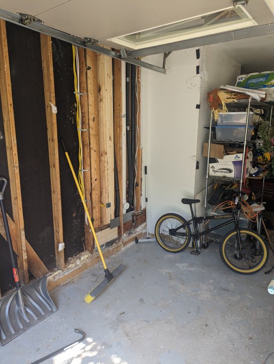

  5. This has happened twice. The addition was completed last winter. It got very cold once afterwards, which is when we identified the problem, had the plumber/builder/insulation people come back out to "fix" the problem. I discovered last week that it was, in fact, not fixed. I definitely got the faucets dripping trying to thaw them and prevent refreeze. I was hoping for something a little more permanent going forward.

  11. I'm not tearing that wall apart and putting it back together. The odds of my builder doing it without a lawsuit being involved are none to none.

  13. LeAnne posted a new update to Help Mark Heal: Overcome a Life-Altering Crash Hospital is planning to send Mark home even though he isn’t ready. Hoping we can afford home health as my insurance is up at end of the month.

  15. The wall mount option is definitely interesting. Maybe because I've been running this gas buddy but how hot does it get? No fire hazard? I have some garage/industrial shelving in front of that area now that would sit pretty close to that wall and I would worry that someone would put something too close to it. Foundation is poured wall for a basement and yes the wall that they ran these up is a foundational wall.
