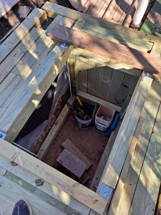

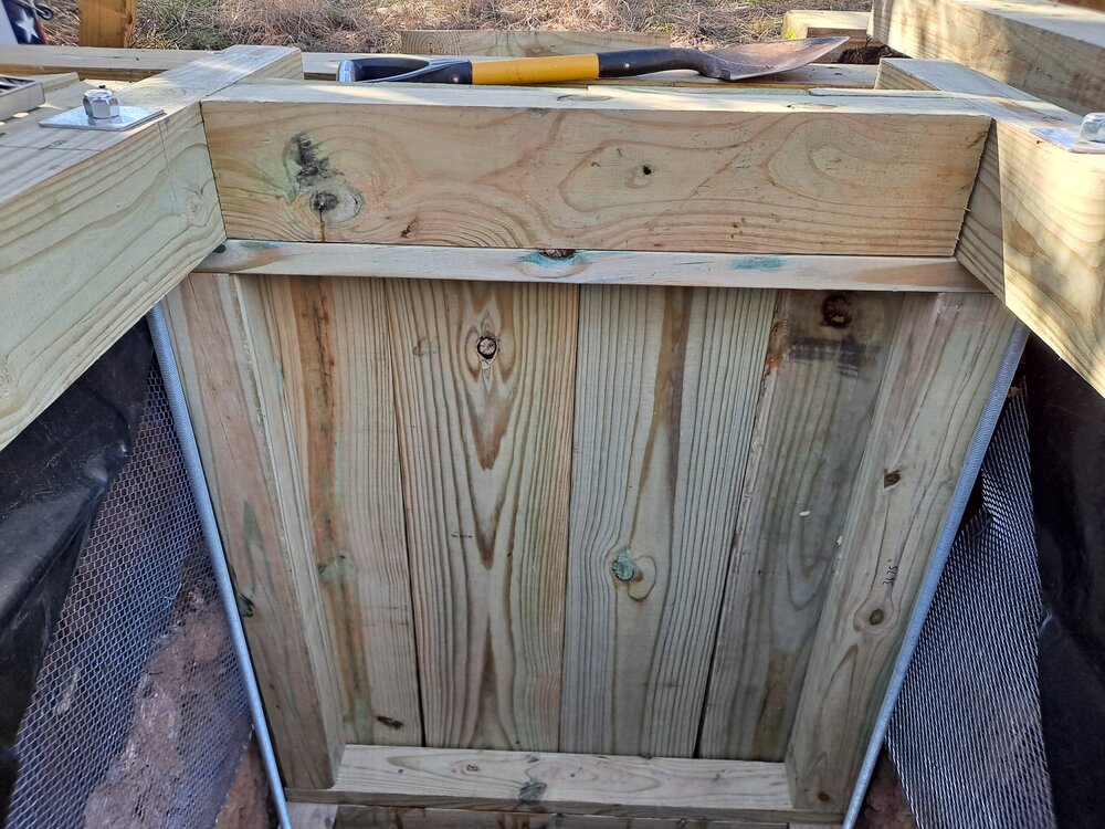

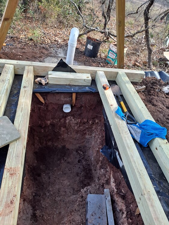

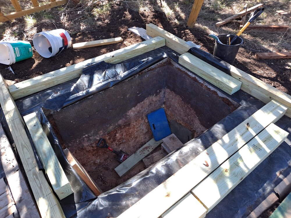

  1. I poured a concrete collar all the way around. I'll tie them into the longer 4x6s that I've built up pads for. Probably headlok screws from the side (but maybe regular lag scrolls) and maybe some extra all thread (cut the 72" down to 54" or so) to some 4x6 I'll use as a spreader. I was going to buy 4 joist hangers, but they are like $30 ea. Still might, dunno.

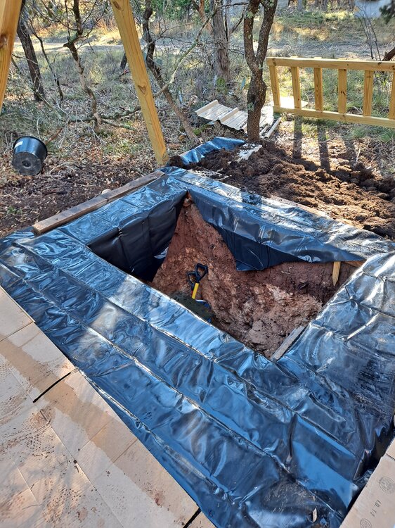

  2. Progress! The hole has been damp. Im not sure if that's ground water migrating (probably mostly through the top 20" of clay) or what. Just before Xmas I put down a 10x13 45 mil pond liner with the hope of being a little drier. Covered with cardboard and mulch to protect from boots and uv. I also figured ventation would be good. Put in 4" sch40 through the side and up. Later, when I get deep, I can put a incline blower to move air. Also got some 4x6 cut and tentatively placed. This will be the top of my first set. You can start to see the 30" clear width (after 2 3.5" widths and the space for lagging, the shaft timbering makes the hole cozy. I still need to knock out a little bit in the one corner but I'm pretty close to putting in the first set of hanging all thread and 48" span.
