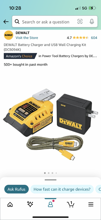

  21. Dewalt has a bunch of 20v usb charger, a 200w /120v inverter adapters and even a multi battery 1800w inverter “generator”. Lots of options. I bought this one that has USB A and C out out to charger phones etc and it also takes usb-c charging inlet to charge 20v batteries off of a usb-c wall charger or from my truck 12v usb-c outlet which is my primary need. It won’t power 120v ac devices though, need a different adapter for that.
