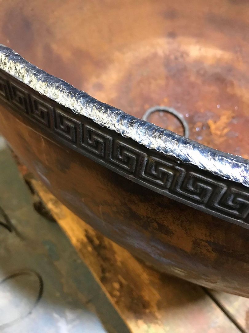

Any surlsters going to be lighting up in 2020? This is a fire bowl I recently finished building. I've got plans to
do some more in the new year along with other art / furniture projects.  Whatcha building this year?

Very cool. Nice looking weld
I appreciate that.
There was a gap... the lip of the bowl vs. the greek key flat strap constituted an even up to 1/4" rise throughout the project.
I really  like E7014 here... it's a great blending rod. I think I came in around 110 amps. .. 7014 It sucks for big  gap fill (porosity) but fuck if it doesn't lay down some brass.
I love me some E7024 but that would have been too much in this situation also. That was a narrow lip between the bowl and the strap
7024 might have run away with it.  7018 would have been too slow... 6010-6011 too crude..
so here we are.
So... that's a stick weld. E7014....I parked the arc on the bowl side and just when I saw it wash over.. I cranked the electrode over
about 80 degrees to the other side.. Just on the high spots. the rest  was a weave just to let the arc push hold it together. . Cheers.  I love this shit.
Edited by Marfa Low Crown

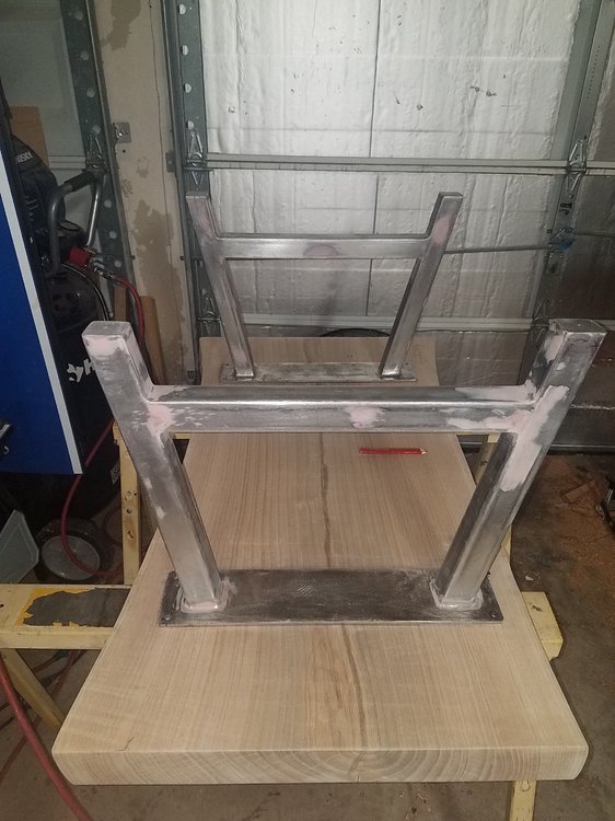

Here is my first stab at welding up some live-edge table legs.  Its for my daughter so I wanted it to be perfect hence the Bondo, which helped my over-aggressive weld grinding.  I bought a little hplv painter and will be painting them soon.
I inherited my dad's old 145 amp mig welder and am having a hell of a time getting it to weld worth a shit.  Mainly the wire sticks to the tip.  It has seen a shitload of welding so I don't know if it is just worn out or what.  I can get on my dad's new mig and weld decent enough.

New working pens
Nice. Definitely spent some time doing that. What gauge is that square tubing?
