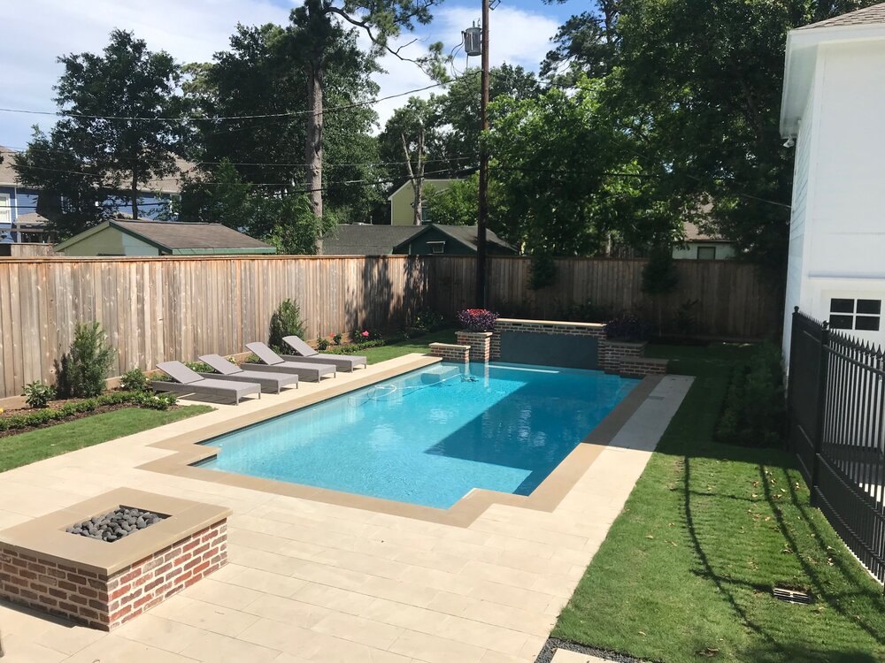

Just about ready for our first summer with the new pool. Landscaping and new grass all went in about 3 weeks ago. Lay out chairs arrived this weekend. Just need our furniture for the area around the firepit. And the cracked pump housing for the waterfall feature is still backordered for a while, but that's not exactly a necessity.
