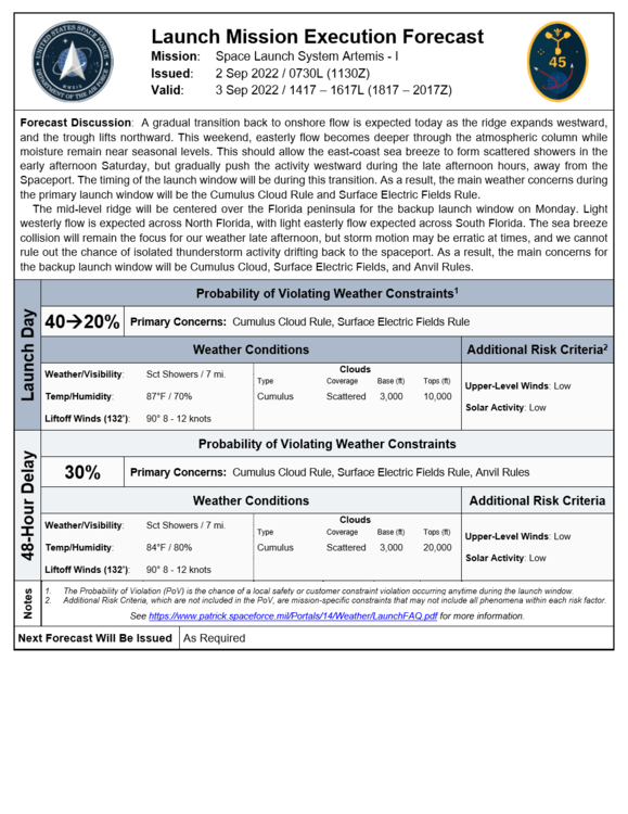

Saturday Wx improving now to 60% GO at the open and 80% GO at the end of the launch window.
869483754_SLSArtemisIL-1Forecast-3SepLaunch.thumb.png.9921a64d442138bd6503f0b3ab0a3563.png
Still raising a slightly-concerned eyebrow at the "just flow the H2 earlier" and cross your fingers plan ... they're also rationalizing away the issue and hoping that (1) understanding of the (newly configured) system and (2) relying on sensors that are indirectly measuring the situation will get them through launching this beast.

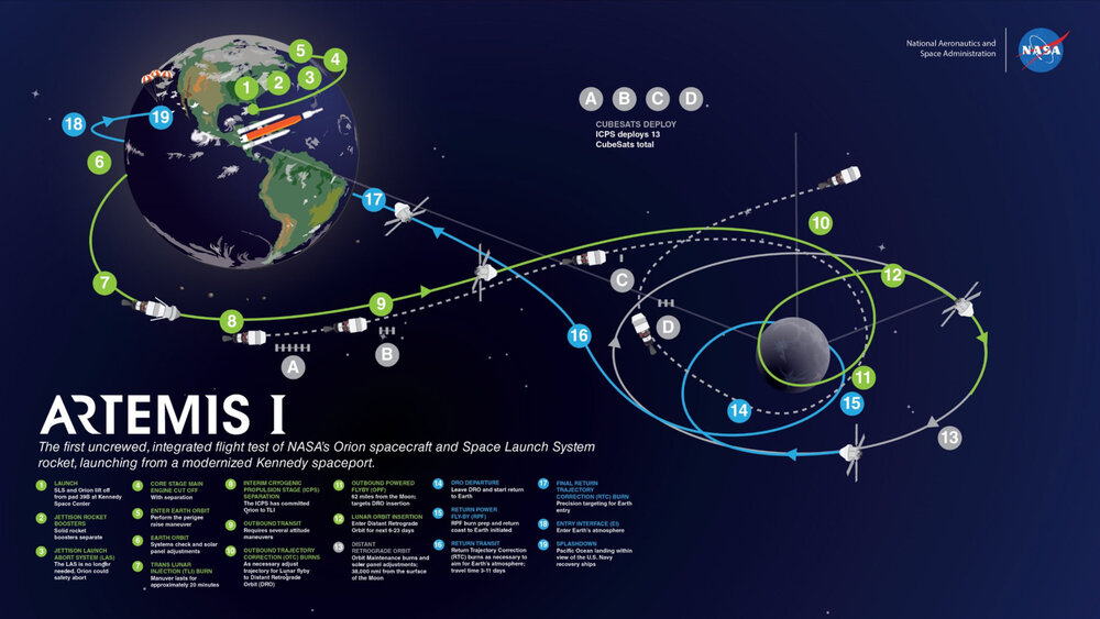

Here's the cool flight infographic if you haven't seen it lately:
