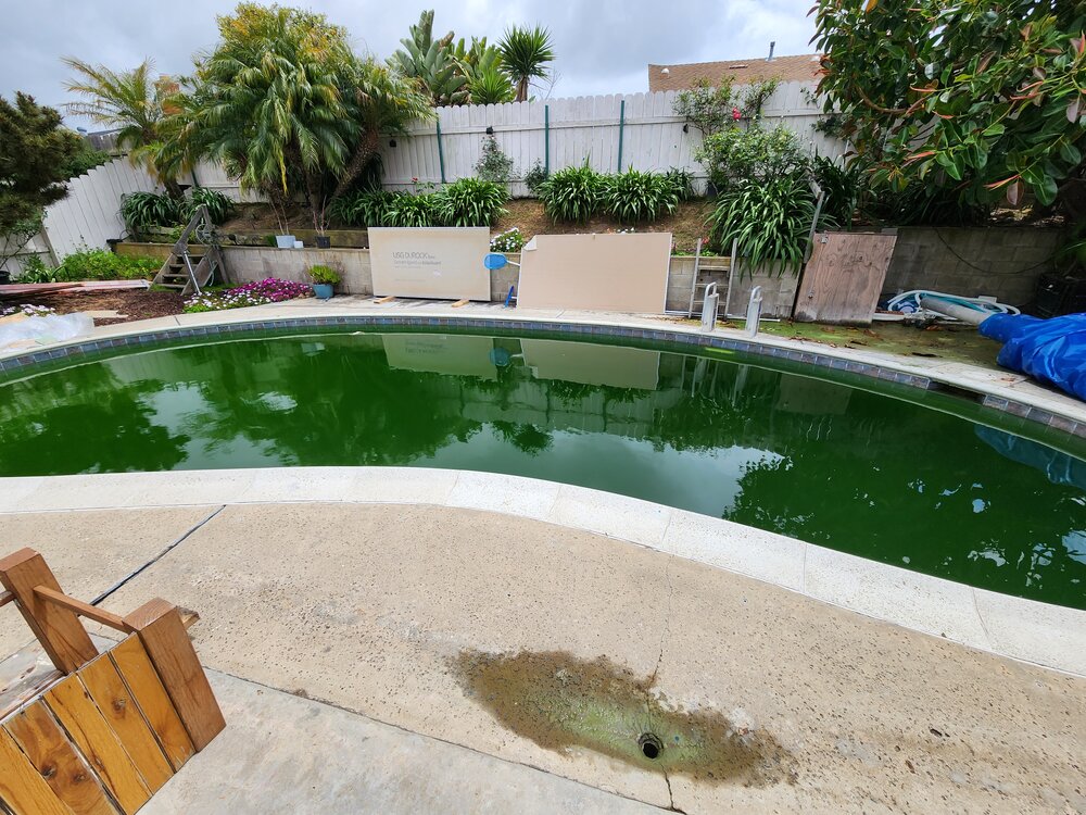

Mind you, this is one day AFTER scrubbing, 6 pounds of shock, and an entire 32oz bottle of algae killer.
And if I tell you it looks better than it did yesterday, you get the idea.
You can see where the drains on both sides overflow when I purge the filter... which I pretty much have to do every hour, or the pump just gets stuck on clogged shit and nothing flows.
Oh, and don't mind the drywall and construction stuff, we're having some remodeling done, too...

Dude, drain that shit.  Then power wash, refill, and then load it up with chlorine again.
Can't. Pool... doesn't have an actual drain. It does, sorta, but I've got no idea where it goes.
Also, I live in the desert. I don't think I can afford the water cost!
Edited by Rimbo
It's worth adding... this isn't the first time I've had to do this. Ask me about Spring of '21...

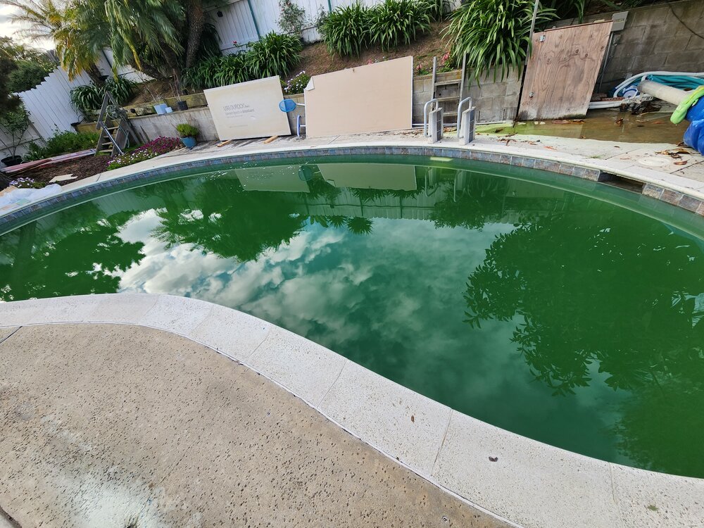

Day 3: How it started...
At least it's turquoise instead of dark green. That's progress. Have now dropped 12 pounds of shock in there.
Got to the point where I was having to purge the filter every half hour, so I finally gave up and disassembled the whole thing to clean it completely. The spice must flow...
Come to think of it, the filter being clogged and water not flowing is probably what allowed the algae to grow in the first place.

Oh, the algae will consume the chlorine as it dies painfully.
But... yeah. Filter. Clear out your filters, folks.

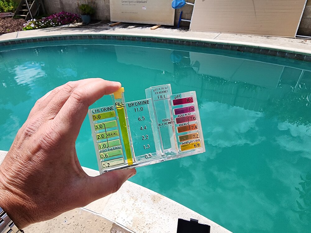

DAY 4
@fattyflattie, like I said ... that much algae will consume the chlorine:
That's a yellow that's slightly below 5.0.
Water's a milky cyan now. It's basically all over but the vacuuming; vacuum needs to scoop up all the dead algae bits, a few more algae bits need to die. I feel comfortable putting the solar cover back on and check tomorrow; once the water temperature has heated up and the vacuum and pump and remaining free chlorine have done their jobs.
This weekend, I'll clear out the filter again, and we should be good to swim in it as soon as the water gets back up to a decent temp.
That’s awesome you have it under control.  We’ve still been knocking out 6-8 spots a day, then checking chlorine levels.   My water is crystal clear, it’s just got a few of those damn dots on the bottom.   I think I’ll have it licked by next week, and if lot, I might try and shock it.   I’m a saltwater guy that’s only been doing this a year, so I’m nowhere near a chemist.
Yeah, cleaning the filter out completely was the secret sauce. I knew the filter was due, but fooled myself into thinking that I could put it off and just backwash until the algae was gone. Because I'll probably have to do it AGAIN once the pool has completely recovered, for all the bits that just got cleaned out. That, and the lack of flow from the filter being clogged is most likely why the algae bloomed so much so fast in the first place.
Did I mention I got a newer, better pool vacuum this year? That's probably why and how it got clogged so much... I never cleaned the filter after I killed the algae and vacuumed it last month.

I've had tons of pool problems lately and it has cost me a fortune. Things are looking up, though. When we built the pool, there was a pre-existing covered deck without gutters. So when it rains, tons of gravel and water flood the pool. Because of this, we get algae and broken pool equipment from the flooding. I've hired a lot of different pool guys and they have all kind of sucked. The last guy came to clean the pool filter, but he texted me that it was too dirty to clean and their price for replacement was $1000 plus labor. When I came home, our flex garden hose was broken and water was pouring out of the filter. So, I turned off the pumps and ordered $200 filters from Amazon. On Sunday, I replaced the salt water chlorinator, cleaned the drain by the pool equipment, replaced the pool filters and added pool salt and shock. The pool looks much better today, but I wonder if I should clean the filters after only a day's use since there was significant algae in the pool.
Next weekend, I am going to cut the deck roof back and make it straight vs the multi-rounded design that is there now. Then, I'll have someone install gutters and I should be good to go. It's been a battle because of shitty labor, but now that I have the impetus to do it myself we should be good for the summer.
On the bright side, after one more filter cleanup, my pool is nearly in fighting shape; needs a little vacuuming and a little more heat, but it's otherwise good to go!
