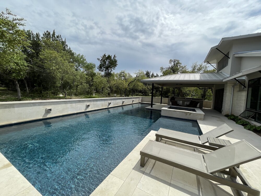

Well, I’ve been avoiding this thread for almost three years.
My pool was constructed with shotcrete that caused ASR. The shell started cracking. After a year empty and another year plus with an attorney and a settlement…last weekend we finally filled the new one.
The only cure for ASR is complete demolition of previous pool/concrete etc. The post demolition photo is attached. There was a pool that looked similar prior to this demo.
It wasn’t worth it for the last few years…but we finally have our pool/backyard back.
It was nice to tweak a couple things but damn…feel sorry for the 100’s (possibly a lot more) of other people who had this issue but discovered it later and may not settle/get anything.
Cray cray.
Cray cray.
Looking forward to another hot summer.
I hate you all. This is beautiful, and I'm a petty, jealous man right now.
Cray cray.
Had to google ASR.  Crap.  I could be the next victim.
We have a crack from top to bottom in one wall.  I pointed out the large voids in the shotcrete when they pulled the forms and was told. oh that's normal.  18 months later the crack shows up. It took a year to get their insurance adjuster out to look at it and he says we had a bad installation.
After the forms were pulled in 2021
Cracks go all the way from back wall into the plaster and cracked the coping
Cray cray.
Unfortunately I think I’m in the same boat. Would you mind if I reached out via PM to pick your brain?
Thanks. Having a pool ripped out of your backyard with jackhammers for months was not a fun experience…windows shattering on other side of house from vibrations. Was unreal watching. But happy with outcome.
Can I ask where you are? It's obviously central Texas, but you look out of the city a little bit. The pool is gorgeous, but I'm digging the house and the legroom you have.
