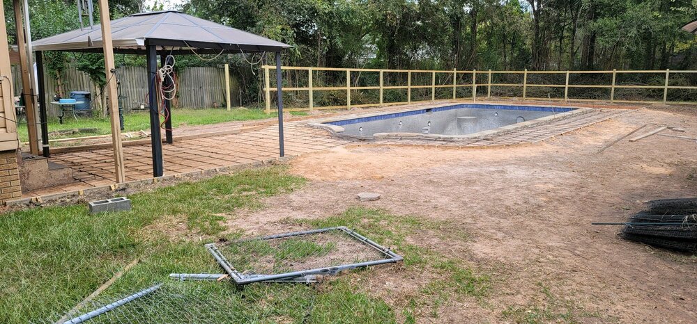

  • Here are some after pics for the project.  We started last September and have been swimming since Easter.  Pavilion/outdoor kitchen have recently been completed.  Sectional in the pavilion is incomple
  • Weather was a big slow down with the rain we had last year. Also removing an in-ground floor system I didn’t realize was installed was the other big delay...I don’t want my pool to look like it has 20
  • Before: pool built in the late 70’s. Major structural issues and ancient equipment that cost a fortune to repair over the years and maintain. Also had dated landscaping and flagstone After: wante

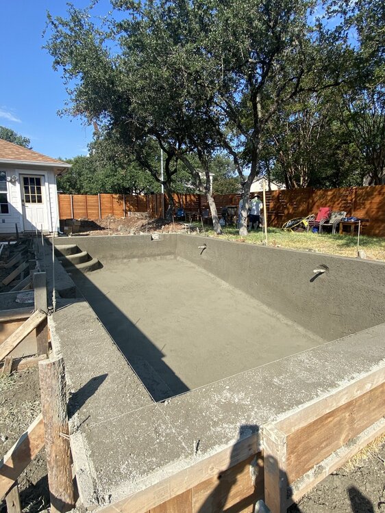

Gunite question, are you supposed to start wetting it the day it’s shot or wait a few days ?
Same day, twice a day for 2 weeks

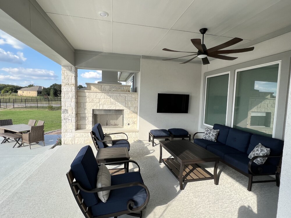

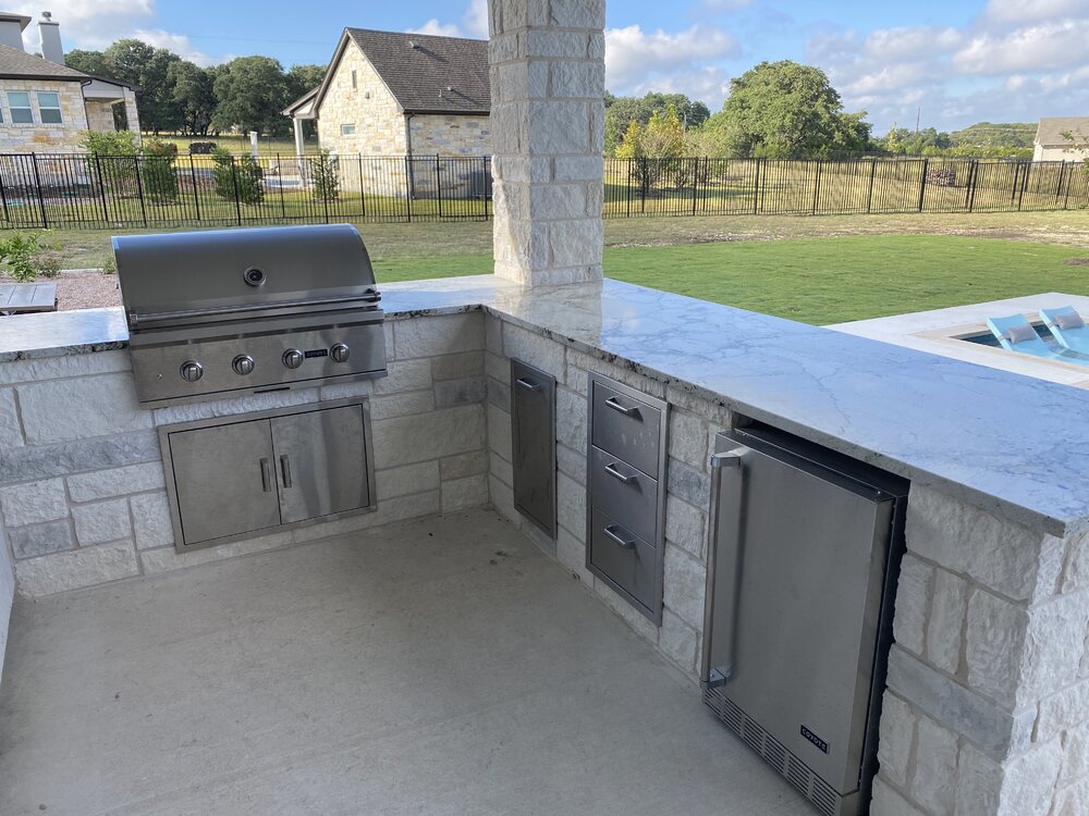

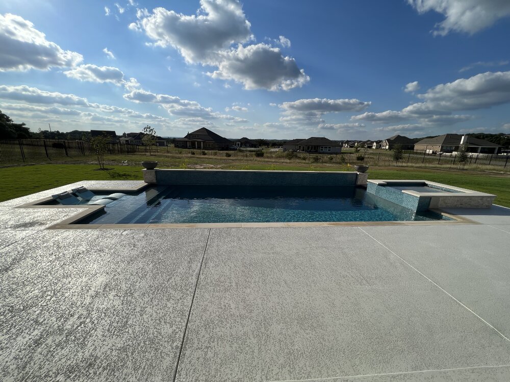

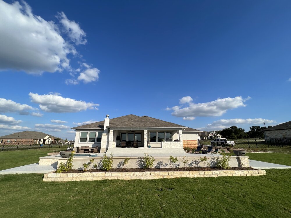

Very happy with the finished product.  Pool company did the fireplace and outdoor kitchen as well.
Nice setup  but something is really weird with those pictures.  Some kind of distortion.  I really like the outdoor kitchen; that is something I wish I had.
Just used my phone.  Maybe because I was using the wide angle lens?
What pool lounge chairs are those?  Are they the $500+ a piece baller ones or something I would be willing to buy?

@TexEx15
nice setup. Have similar kitchen/stone, now considering doing a matching fireplace on the other side after seeing how that looks.
I also need to add an overhead vent over the grill which I’m not pleased about.
