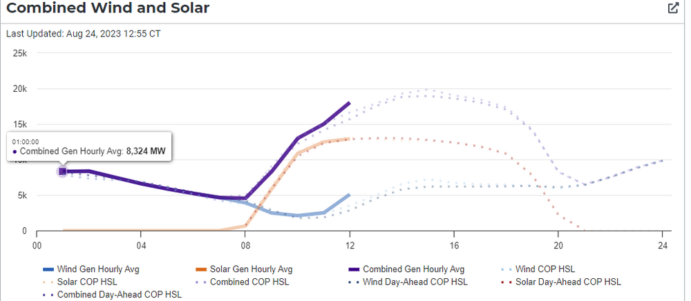

Re: ERCOT Fuel Mix from yesterday, 08 23 2023.
Coal & Nuclear (at the bottom) are the "base supply", always on with little variation.
Solar & Wind (at the top) are the "intermittent supply", on/off based on variable atmospheric conditions, with solar having the most extreme variation.
Natural Gas (in the middle) is the swing supply, on/off or increased/decreased based on the supply demand profile.
Notice how the wind generation tapers off in the early morning hours and there is a slight increase in gas generation. As solar generation begins and wind generation increases, the increasing "renewable" supply is ~ equivalent to increasing demand, and there is a marginal change to gas generation. As demand increases through the hottest part of the day, the renewable supply is max'd out and the new supply is ~ 100%  generated by natural gas. As the solar and wind power generation decreases in the late afternoon, gas power generation increases and peaks to satisfy the increasing demand profile.
THE ONLY THINGS PREVENTING NATURAL GAS POWER GENERATION FROM HAVING A SMOOTH SUPPLY PROFILE IS THAT, (i) there is not enough gas, or (ii) NATURAL GAS POWER GENERATION IS "INTENTIONALLY THROTTLED (by ERCOT)" AS IT IS SIMPLY NOT NEEDED. (Yes, I am intentionally shouting because this same shit is posted every damn day I look over here, which thankfully, is about once every 3-4 weeks.)
The "unexpected lack of generation" is simply an ignorance of not being able to understand a simple concept, that at a specific point in time, it is simply not needed due to the availability of other supply, primarily solar.  The natural gas power generation is reduced, per ERCOT, because it is not needed on a real time basis. Please note how the power generation profile for natural gas very closely tracks the total supply/demand profile, which is indicative of the natural gas supply being the primary swing (variable) supply in the power generation portfolio.
Ii is not that complicated, if you need more power, burn more gas.
With that said, a cloud, or a tropical storm, drifting over a solar array can be offset by existing operating facilities ramping up production, on demand.  A major generation facility dropping offline or a transmission line interruption is a much different issue.
All of this is true. But there still could also be unexpected unavailability of natural gas capacity (e.g., a generation facility dropping offline or being unable to spin up). I don't have any evidence that is the case here.  We'd have to see these alleged local news reports to understand and verify whatever is being said. From my view it looks like this potential shortage is due to high demand and lower than typical wind generation. That's always going to be problem when a grid has relatively tight margins between peak demand and peak maximum capacity.

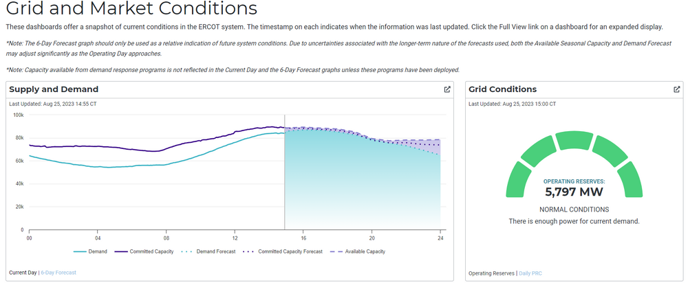

In nice news, wind still trending a couple of GW above the estimate. Real time prices are staying low as a result.
5 hours ago, Dahobbs said:
Slightly good news, wind, so far, is trending above estimates.

Holy shit how close did we come to rolling blackouts?  The Mayor of San Antonio put this out earlier
I was surprised by that too.
Houston, Dallas, and Austin news stations just had the garden-variety “hey, try to conserve this evening” stories posted, while the city of San Antonio was sending out emergency alerts to cell phones saying “Be prepared for power outages beginning at 6 p.m.  Outages will be in 15-minute intervals.”
Did the SA leadership just overreact?  Did they misinterpret what ERCOT was telling everyone?  Or did ERCOT tell SA that it was first in line for blackouts?
San Antonio consumes a ton of energy.  They are one of the fastest growing players in the data center game.  Microsoft can't build them fast enough for the government and its AI capability.  Those data centers gobble more energy than Bob Stoops gobbles cock
Edited by FartingMonk
I suspect this was the city and CPS Energy trying to stay ahead of any fallout from potential outages. CPS has been catching a lot of flack ever since the winter storm grid failure. At one point there were calls for the city to sell CPS so it could go private.
Most of the public criticism of CPS is really an ERCOT problem and I suspect this was the city trying to let everyone know that if shit goes down it's because of ERCOT.
That sounds quite plausible.  ERCOT's first move every damn time is to blame certain aspects of the energy portfolio.  May as well borrow a page from their playbook if you're a muni or co-op and blame them first, too.  Over-alerting people to energy outages is annoying but if I can tolerate 9 Amber Alert warnings in the middle of the night for Wichita Falls, I could listen to the S.A. Mayor and maybe check in on my older neighbors.
