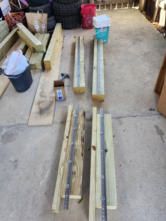

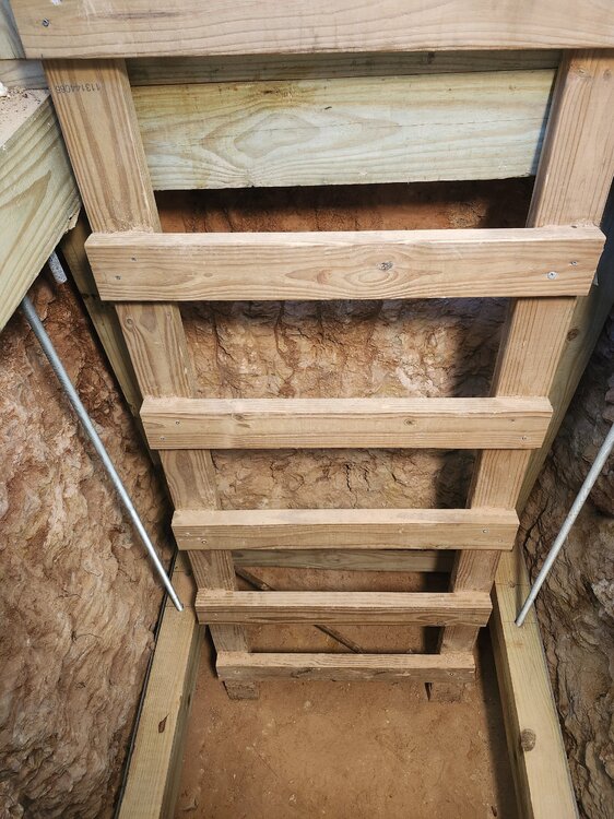

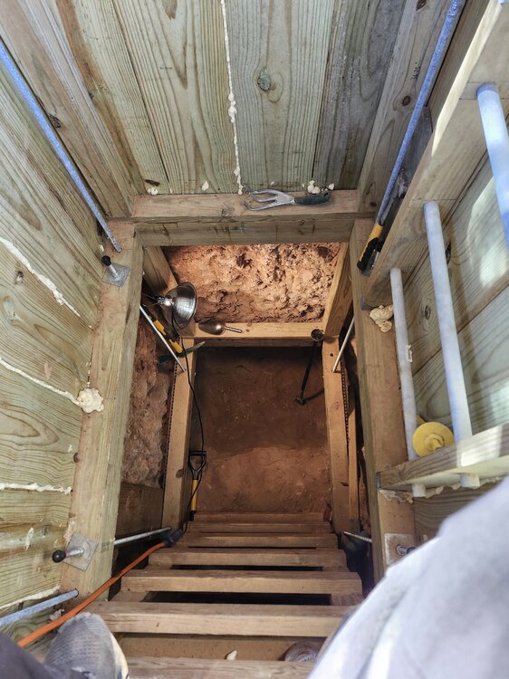

Got the 4x6s and hanging volts for set #2. Feeling pretty good about it.
The slotted angle iron is there to hold up shoring.
Inevitably I find that some walls need to be widened a little. Pulled out about 16 buckets and didn't get any deeper. It's crazy how much volume is in a half inch of 3x4 surface area.

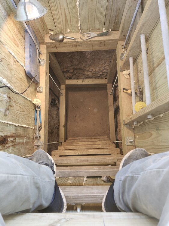

Looking down. About a foot to a foot amd a half below the second set. The posts aren't really in yet, just friction fit. I'll nail the spreader to the main and glue. I probably should cut the 5/8 threaded so it doesn't poke me.
Bottom level view:

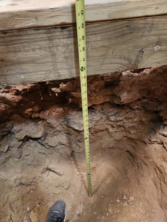

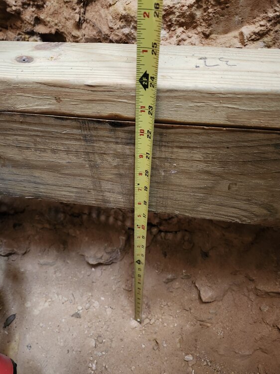

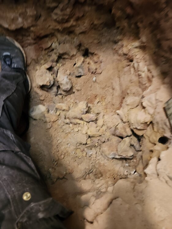

It was about 30 degrees on Friday when I arrived. About 41 in the hole. When I started the deepest point was 17 inches below the second set. 20240119_103233.thumb.jpg.8bfa19c5a7fe06192fdc92b521828cc7.jpg

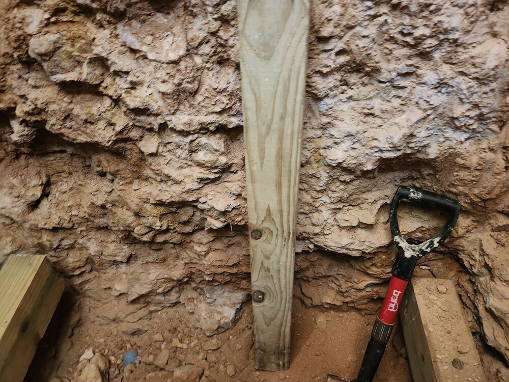

Had to jackhammer a rock layer.20240119_125217.thumb.jpg.ff609a9c7d317319388470a9cfc4744e.jpg
Got it down (on one side) to about 35 inches below the set

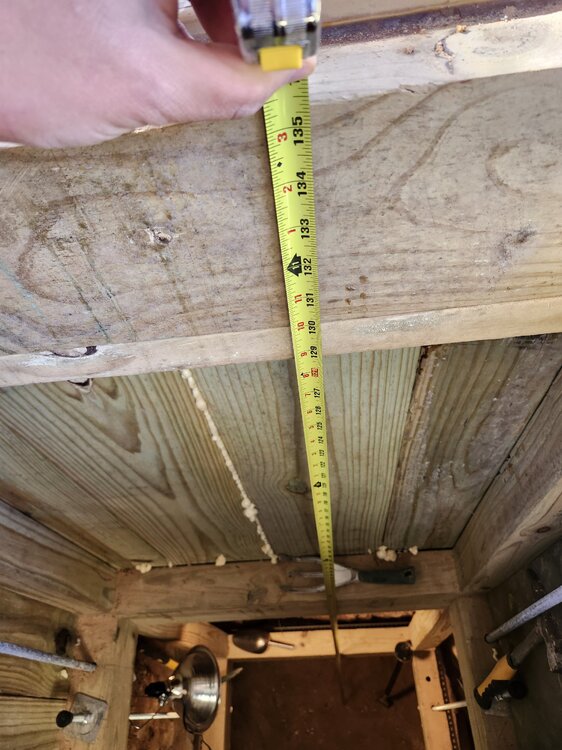

Total one one side about 136 (11'4")20240119_140242.thumb.jpg.aaebb6e49c787e291deec7a3b69c5381.jpg
My wooden 8 ft ladder us too short to put in the deep end. I'll have to bring up a new ladder when I switch sides next time. It gets too deep (too much bending to shovel and scoop) if i dont even it out from time to time.

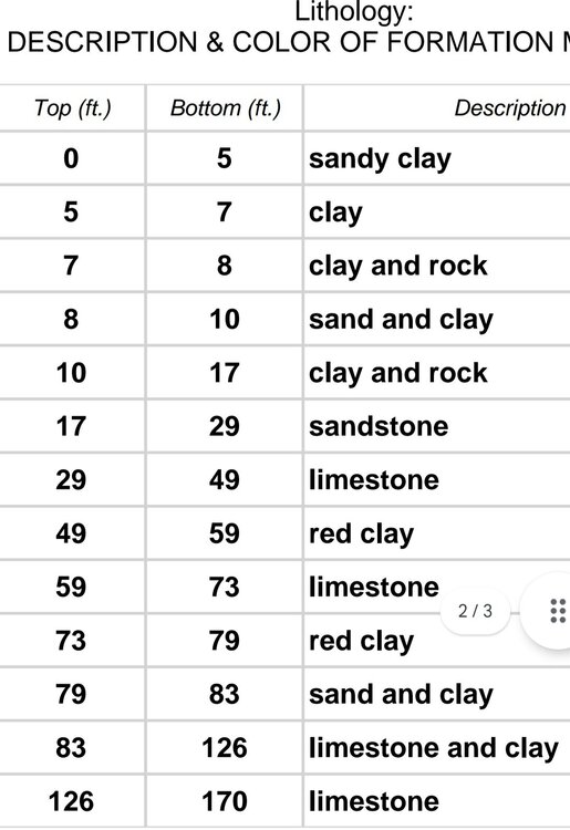

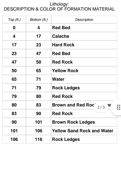

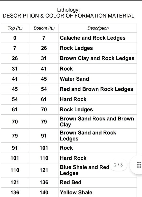

Use these online tools to find the nearest well and check out their report:
https://www3.twdb.texas.gov/apps/WaterDataInteractive/GroundwaterDataViewer/?map=sdr
Here's a sample near San Angelo (I think that's where @CleverNickname is digging).  Anyway, page 2 details the soil & depths they encountered during the drill:
https://www3.twdb.texas.gov/apps/waterdatainteractive//GetReports.aspx?Num=168240&Type=SDR-Well

Cool. A lot of variety in the area (mills county), I mostly would attribute to well diggers being less than expert and/or lazy. But these seem reasonable guesses:

This is interesting.  Ive got 360 acres in Runnels county with two wells but neither is listed.
